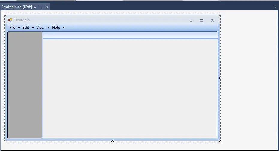

首先是创建自定义控件 EmbeddedConsole 的代码:
using System;
using System.Windows.Forms;
namespace WinFormConsoleIntegration
    public partial class EmbeddedConsole : UserControl
        private TextBox outputTextBox;
        private TextBox inputTextBox;
        public EmbeddedConsole()
            InitializeComponent();
            outputTextBox = new TextBox();
            outputTextBox.Multiline = true;
            outputTextBox.ReadOnly = true;
            outputTextBox.Dock = DockStyle.Top;
            this.Controls.Add(outputTextBox);
            inputTextBox = new TextBox();
            inputTextBox.Dock = DockStyle.Bottom;
            inputTextBox.KeyDown += InputTextBox_KeyDown;
            this.Controls.Add(inputTextBox);
        private void InputTextBox_KeyDown(object sender, KeyEventArgs e)
            if (e.KeyCode == Keys.Enter)
                string input = inputTextBox.Text;
// 这里可以添加将输入发送到控制台处理的逻辑
                inputTextBox.Text = "";
